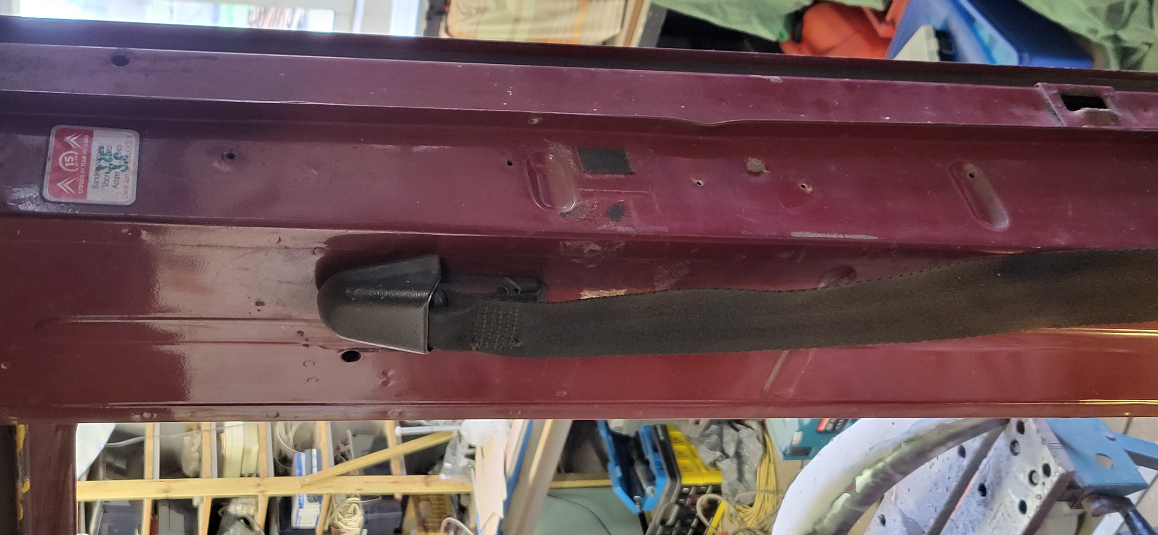

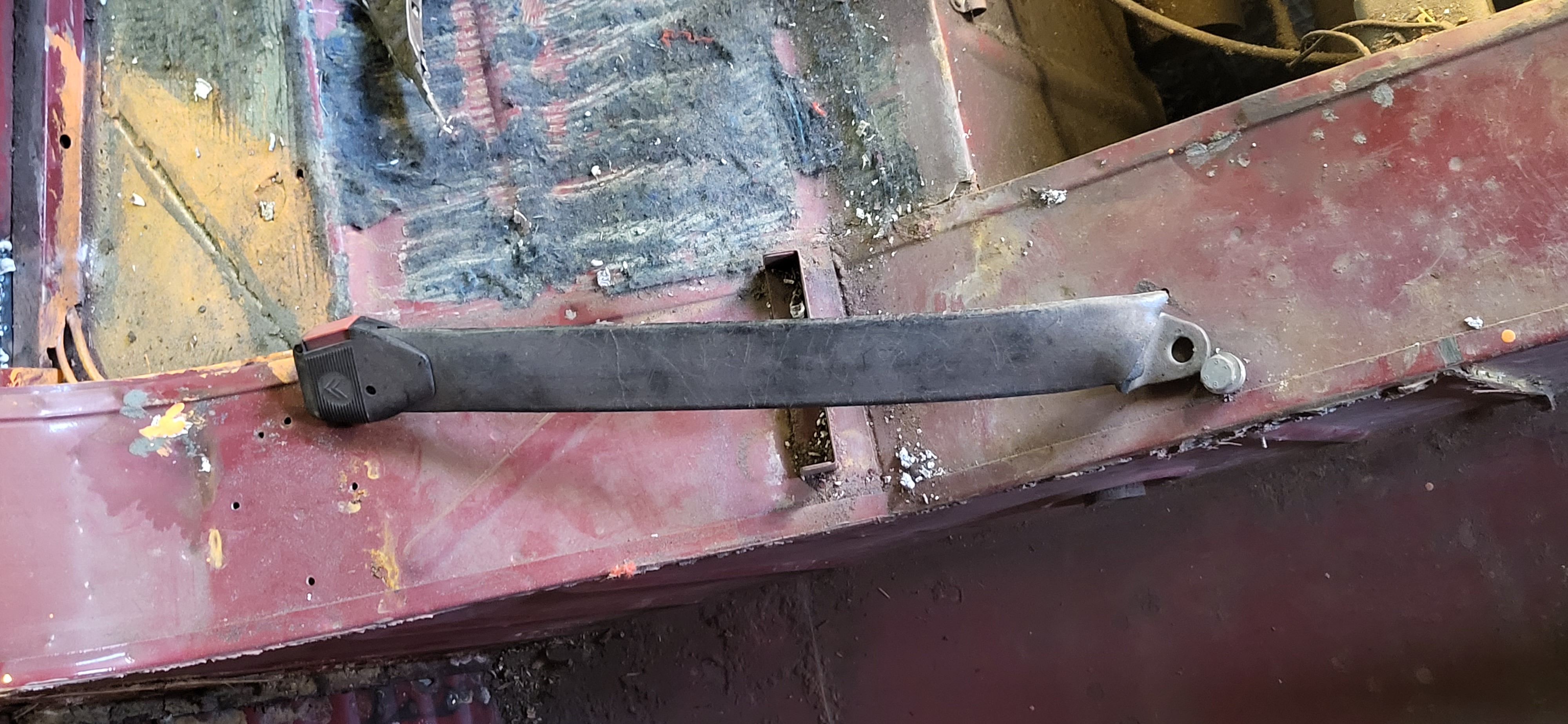

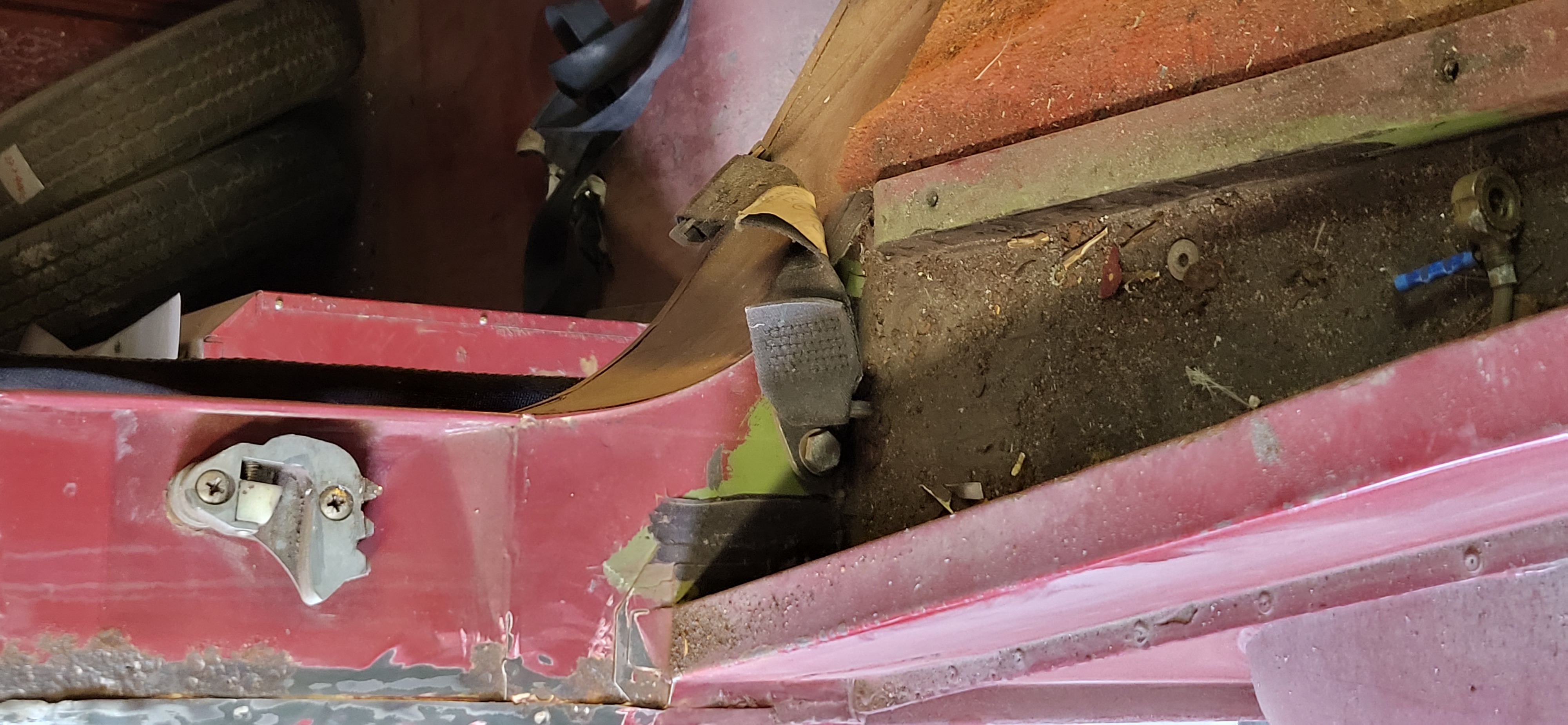

Hi Kat and Garric,
As promissed I made some pictures from the mounting places of the belts.
I hope this gives you the wanted information. Of course you have to make your own reinforcements to make the needed firmness.
If you need more info please let me know.
Kind regards,
Dries
Opmerkingen bij bestand: The right seat left lower mounting. This has a long plastic cover.
3CE87286-727C-474F-8F1E-392C5718BD93.jpeg [ 1.48 MiB | 7156 keer bekeken ]
Opmerkingen bij bestand: The right seat lower mounting
01EB6DA1-31CE-4DB0-809E-DA8481BB62DC.jpeg [ 1.3 MiB | 7156 keer bekeken ]
Opmerkingen bij bestand: The right seat upper mounting
698D4B03-CBB9-470E-9A0B-421785354410.jpeg [ 1.36 MiB | 7156 keer bekeken ]

Many Thanks Dries!
Sorry for the late reply. We appreciate you taking the time to photograph!

 Berichttitel: Re: Installing seat belts 1966 plateau
BerichtGeplaatst: di 21 maart, 2023 22:04
Geregistreerd: ma 17 mei, 2004 18:02
Berichten: 45
