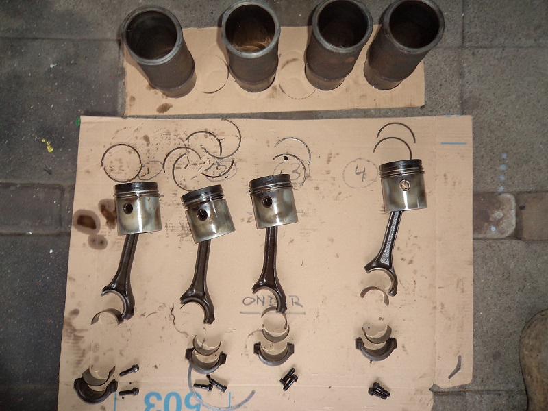

advice: please keep all (!) parts sorted very exactly in the way you took them out of the cylinder block ! (photo 2) You 'll have to replace them in exact the same way as they came out ! In this matter also great attention for the bearings of the big ends ! Check if these bearings still are in good shape.

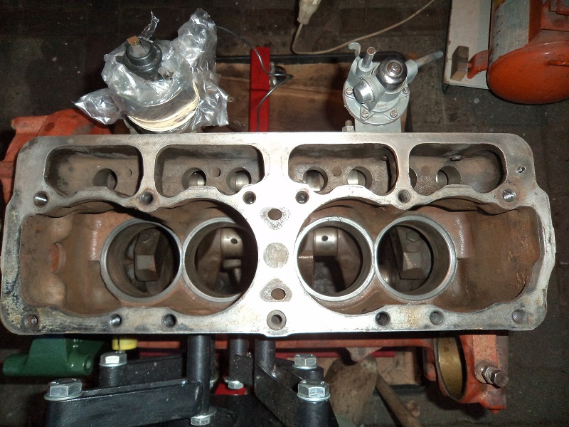

The cylinders (sleeves ?) itselves can be removed by little wobbling of the upper side of these tubes (rubber hammer ?). Before replacing them you'll need new (paper) foot gaskets (and a little grease to stick them on their places) and fully (!) cleaning of all surfaces where they touch down in the cylinder block. (photo 1)
And, as your photo' s show, there is still cooling liquid within your block. You better let if off completely before continuing ... to provide a mess ... :lol:
