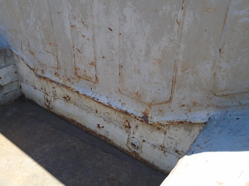

I'm new here and recently acquired an HYP Plateau pick up. It rained here a while back and the rear bed (floor) of the Plateau had 4 inches or more water in it. I pushed it out with a squeegee.
My question is should there be a drainage hole(s) in the bed perhaps close to the cab?
The bed seems to be rusting. Should I use POR-15 on it.

Welcome here. Even you're HY.
Original there no holes in the floor.
The best place to do that is close by the cabine. There is the lowesd point. Good coating on the floor.
Or make a rooftop over the back.

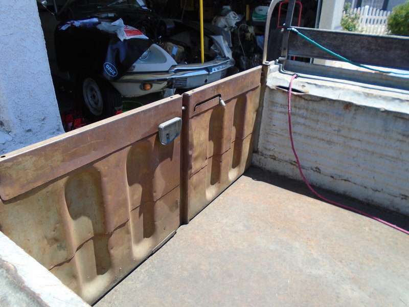

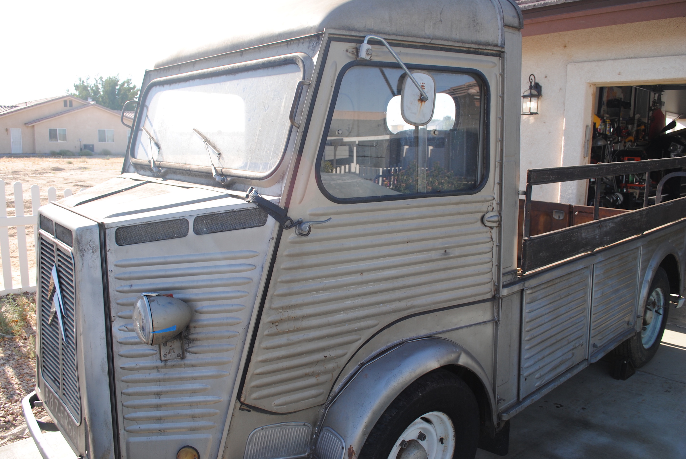

Hi Gert, here's a few more photos.
One of the previous owners imported this from France.
I'd like to add wood to the bed. Anyone have a good way to do this?

Re: Plateau Pickup bed drain holes?
First coat of paint the bed.
Best way to get some space between the metal bed and the wood.

I plan on using POR-15 to paint the bed. I'm going to drill some holes in the bed near the cab to drain the water that accumulates after washing or rain. I'm thinking 2-3cm holes?

You're from the land of pickups, there must be a lot of knowledge there?
I would indeed raise the bed a bit, probably by means of some small beams (like 2x5 cm spaced 30cm or so) lengthwise and then - I'm not sure if google translate does this right - concreteplex (as in: layered plywood boards topped in epoxy, often used as casts for concrete). Or you could use outdoor wood like douglas or treated wood.
Or fully glue the wood to the floor maybe, but I'm not a fan of those kind of almost irreversible changes
And indeed paint the floor first with an epoxy(-like) paint (I don't know POR-15, but seems to be a rust stopper?)
I think most HY's never had a wooden floor in them, maybe some wooden rails to be able to roll barrels of wine
This one does by the way: https://2cvgarage.nl/aanbod/hy-pickup/ You can probably mail him, or maybe he sees it here on the forum (I'm not sure which username he has)

I'm thinking i made a mistake by drilling 3 holes in the bed close to the cab to drain the water?

yes you definitely should not have drilled out the bed. the truck just needs a canvas cover if youre really worried about it. all truck beds rust just clean off the rust and paint it. or store it inside. i have two trucks, and for one i made a cover myself.

if you put wood in the back, like the one at Sander Allderink or with some more spance between the planks, I advice you to use some cross-planks, let say 5. If you at to small blocks of would at the cabin site wit to pins or bolts that slide int the attachements of the "horse" (berhaps covered with some rubber from an on bicycle tire) and to small metal lips under the cross-plank at the back-site, over which the back-doors slide, the whole wooden floor can be taken in and out for claening or painting beneath it.
