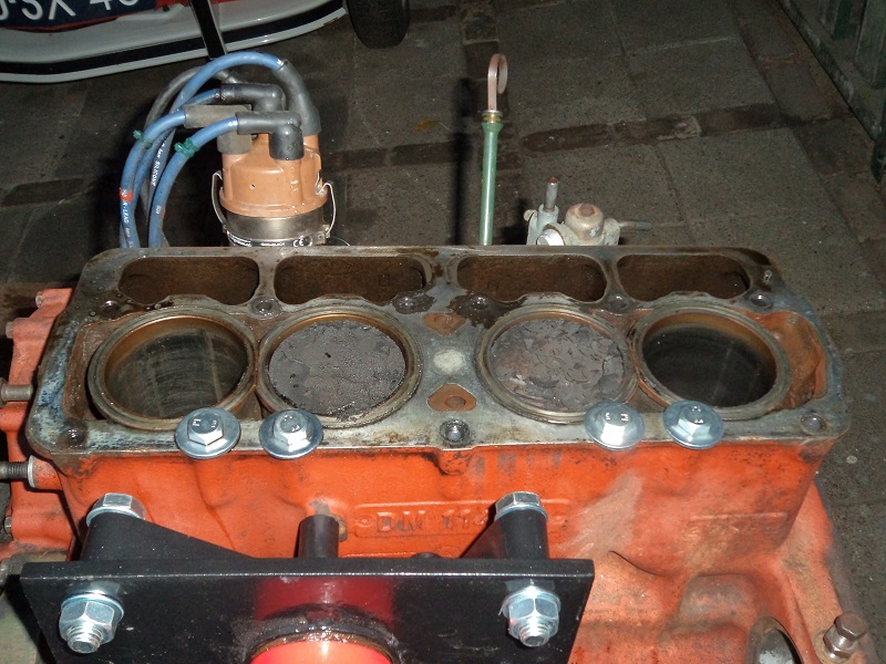

- Locatie: deer isle , maine
Re: best way to change piston rings?
any trick to remove the "sleeves" of the cilinder? tap out from underneath? i don't want to harm the block!
-lelijke Amerikaan
-lelijke Amerikaan
Gregor:
you didn't secure the cylinders before pulling out de pistons ? (see second photo)
Because now you might losen the foot gasket of the cylinders and then you 'll have to renew them too !
You will notice that all first cylinder rings (and maybe more !) will be broken with an engine that old. As far as I know there are no special tools for placing the cylinder rings, so: (carefull) hand job ...
But ... a little "handyman" finds his own solution ! (see first photo) With a large hose clamp ...Putting them back in requires a piston ring compressor (or a DIY solution) and a lot of oil.
